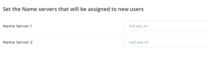

Hi Richard!
Thanks for your reply. In Directadmin (under admin -> nameservers) it is set to the Versio name servers. However I'm not sure this is correct.
I did not get any name server details from Versio. I just contacted them to ask what they are.

It seems the domain name points to the right server, but the server does not point to the right html folder.
I'm sorry, I didn't use external nameservers for so long that I'm not 100% sure anymore.
As far as I remember (if I remember correctly) in the admin configuration section itself, it should still read ns1.hostingcompany.com and ns2.hostingcompany.com.
If you are logged in as admin and choose reseller level, then you can use the "set the name servers that will be assigned to new users" there and point to the acx.nl nameservers. I think you did that so that seems correct.

I've just checked the changes you made with the axc nameservers and it seems it's correct now.
Check the ip in DNS of the customer which is used. This should all be your vps ip's.
