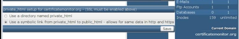

Can you check the attachment and see if you have the same?
