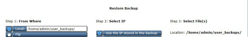

I have noticed as admin there is a possibility to change the restore path beneath "From Where"

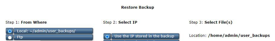

Unfortunatly as reseller you cant change this.
Imho: If there is an option to add something to the path when backing up , one must be able to select this when restoring.
OK, thanks.
I will add it to your "Complete backup system" request, witch is already planned.:)
