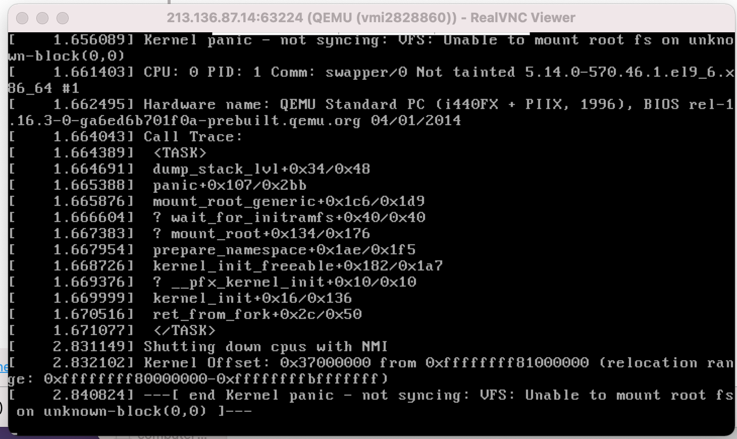

I have recently installed DirectAdmin on my Contabo VPS and completed the CustomBuild process successfully. The installation finished without errors, and I rebooted the VPS as instructed.
However, after reboot, the VPS failed to boot properly and I encountered a kernel panic.
Error message shown in VNC:
Unable to mount root fs on unknown-block(0,0)
I am accessing the VPS via VNC (RealVNC Viewer on macOS) since SSH is no longer available after the crash.

Please check attached file.
Thank you,

That's an OS level issue as @zEitEr has said. Looking at that, your bootloader can't find or can't mount the / partition. Without this, it cannot continue. Might pop a ticket across to Contabo Support if I was you and they can look at your grub loader? They can probably fix the issue quicker than a forum.

You won't be able to boot into your server via SSH if your server doesn't boot successfully as SSH is one of the OS services. Your only options are to try and boot into a rescue environment (whatever one Contabo uses) and check your drives, and the configuration. You'll have to use VNC or something similar due to lack of SSH. That's where I would start first.
Are you able to spin up another VPS with Contabo and see if the problem persists? Installing DA itself shouldn't cause any Kernel issues. Advice with new servers are to run the OS updates first via apt or yum (depends on what OS you're using) and then run the DA install script. That usually irons out any nasties before you install DA.
