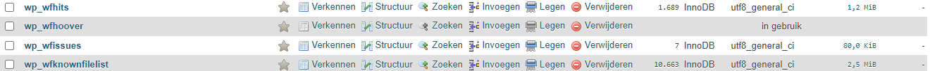

Merely clicking the table gives the following error:
The second screenshot says -in use- - Edited for visibility

The database structure of the hoover table is present, it's just the actual data that is missing. Did MySQL make a whoopsie here?
151126356 -rw-rw----   1 mysql mysql 3.0K Feb 22  2021 wp_wfhits.frm
151126357 -rw-rw----   1 mysql mysql  10M Feb  5 11:12 wp_wfhits.ibd
151135237 -rw-rw----   1 mysql mysql 1.7K Feb 22  2021 wp_wfhoover.frm
151126358 -rw-rw----   1 mysql mysql 4.2K Feb 22  2021 wp_wfissues.frm
151126359 -rw-rw----   1 mysql mysql 160K Feb  5 11:02 wp_wfissues.ibd
150999680 -rw-rw----   1 mysql mysql  995 May 18  2022 wp_wfknownfilelist.frm
150996453 -rw-rw----   1 mysql mysql  10M Feb  5 02:13 wp_wfknownfilelist.ibd
Does this mean I can safely remove the table? The data is not present anyway, so what good would it do to leave a zombie table in the database.
