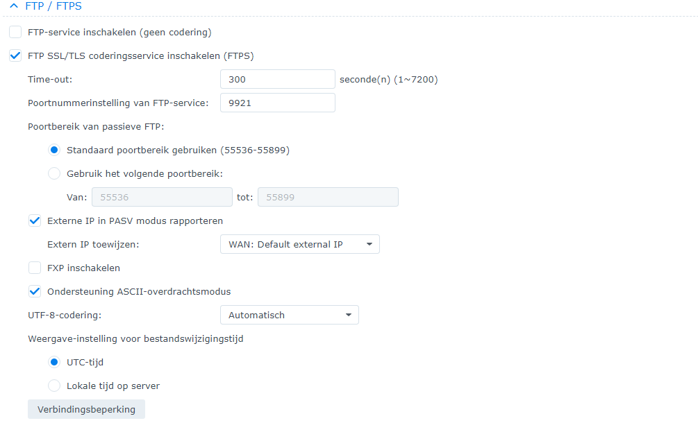

I use the Directadmin Admin_Backup to my Synology server.
It used to run fine but since the update to DSM 7.0 I have the following error on every transfer.
User ****** has been backed up. <9:32:02>
ftp_upload.php exit code: 18
ftp_upload.php output: curl: (18) server did not report OK, got 426
curl return code: 18
<9:32:04>
Please see this URL and check for curl exit code '(18)': https://help.directadmin.com/item.php?id=2127
Although a backup error has occurred, the upload of valid backups would have still been attempted to ftps://*******/databases/******<9:32:04>
I cannot figure out what the problem is.
When I contect to my Synology NAS with Filezilla I do not have any problems.
In attachment you can find my Synology settings.
Anyone that can assist?
