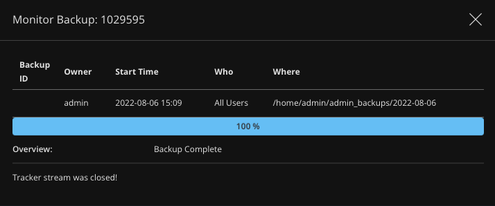

When backing up using DirectAdmin I am shown success messages upon completing the backup, but no files are in the `/home/admin/admin_backups/2022-08-06` folder. Following is an exert from DirectAdmin logs..
2022:08:06-08:19:27: Socket write error: fd is connected to a pipe or socket whose reading end is closed.  When this  happens the writing process will also receive a SIG_PIPE signal.  (Thus, the write return value is seen only if  the program catches, blocks or ignores this signal.)
I searched around but DA support seems to think its related to user input which I can confirm is not the case as I ran the script in full in order to receive the screenshot attached.
Any ideas?
