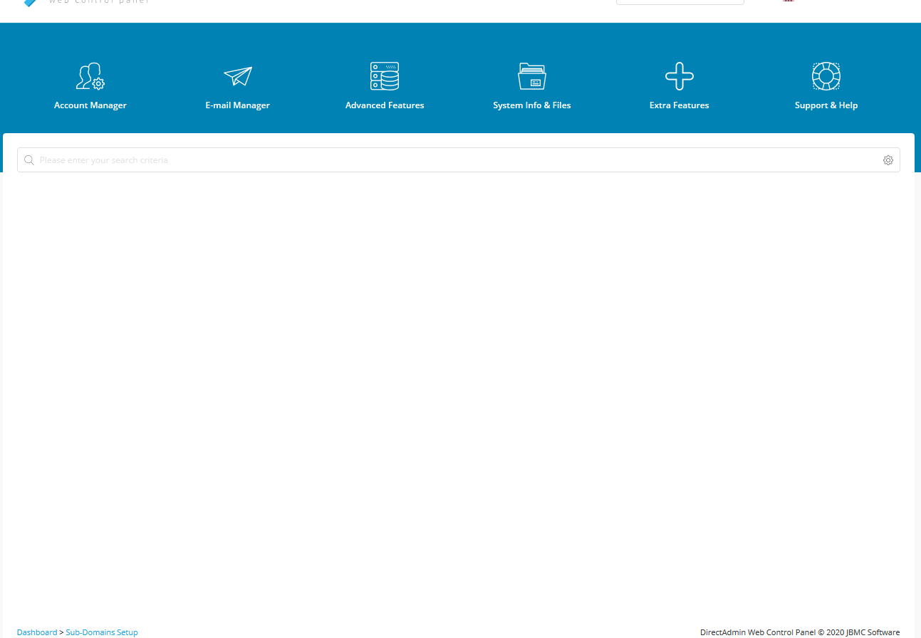

Hello All,
I have installed DA on CentOS 8, every thing seems to be working except the subdomain management page is blank for every user, the error log file is blank and i am not sure what might be the reason. Any help would be appreciated
Thank You.
The Sub domain management is working when Enhanced or Power User Skin is enabled, but not with the Evolution skin.
Thanks it worked, i followed below given steps to update the skin :-
cd /usr/local/directadmin/data/skins
mkdir evolution
cd evolution
wget -O evolution.tar.gz https://demo.directadmin.com/download/evolution.tar.gz
tar xvzf evolution.tar.gz
cd ..
chown -R diradmin:diradmin evolution
