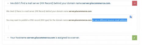

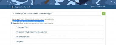

Hello, i'm doing a mail spam test and i discovered that i have a bounce address taken from directadmin when i created reseller account
Since i'm losing 3 points score there is any way to change it?

You're using the mailserver of OVH I see, and not your own mailserver on the server, correct?
Why is that?
If you want it that way, did you configure the DA server to only use external mail?
I don't know how you send that test mail then, but that is where they got that bounce address from.
Oh yes.. check your hostname SOA record, something is off:
Your SOA EXPIRE number is: 3600000. That is NOT OK (according to intodns).
Probably some typo, this should be 3600.

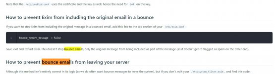

Maybe this can be a solution?
That still provides bounces, it only does not bounce content of the bounced email anymore.
I would use that in any case, because that also will prevent spammers using the bounce system for spam, because the content is not there anymore on bounce.
