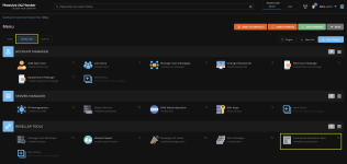

Hello DirectAdmin team,
I would like to report that, as an Admin, when we go to Evolution Settings > Menu > Resellers, if we disable the item "Customize Evolution Skin" (see screenshot attached below) but keeping enabled this feature for the Admin level, DirectAdmin forbid access to Evo Settings to the Admins too.
The effect is that the Admin is kicked out of all the "Evo Settings", despite the feature is still enabled at Admin Level in Evo Settings.
The solution to get back to the Evo Settings as an Admin is to modify /usr/local/directadmin/data/users/admin/skin_customizations/evolution/files/menu-v2.json and set "/reseller/customize-skin" to "true :
"/reseller/customize-skin": {
"enabled": true
But it restore the feature for all Resellers at the same time.
The expected behavior is to disable this feature for Resellers, but keep it enabled for Admins.
It seems that this problem also affect the "Skin Manager" feature?

This has happened for me also... and it locks the admin account out of the Customize Evolution Skin option.
Yep, i also had a ticket to support about something like this, is a known issue/bug, that should be fixed by DA.
