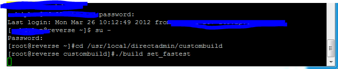

[root@reverse ~]#cd /usr/local/directadmin/custombuild
[root@reverse custombuild]#./build update
The build script doesn't respond anymore (I tried it several times).
How to solve this?
-rwxr-xr-x 1 root root 300485 Mar 18 02:47 /usr/local/directadmin/custombuild/build
Well, when i run the build script (help, update, versions etc) I don't get any outpout.. It waits for me to do ctrl+c and try it again (and it fails again)..

I am using another files server now, that solved the problem.
