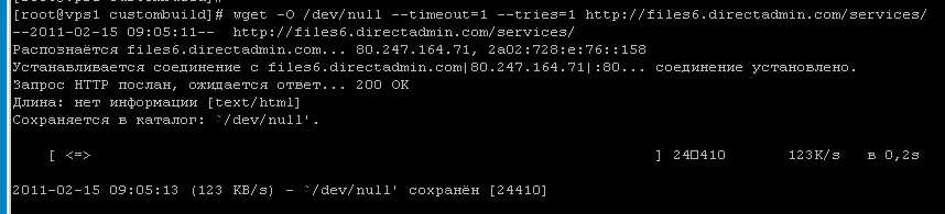

Hello John,
on localized servers, this code:
speedtest()
    ${WGET} -O /dev/null --timeout=1 --tries=1 http://${1}/services/${2} 2>&1 | grep saved | cut -d\( -f2 | cut -d\) -f1
fails (grep returns nothing), because saved is never present in wget's output, it's substituted with a translated word. Something like this attached.
Regards,
Alex.
