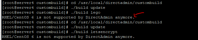

Centos6, directadmin: v.1.643
I did this:
./build update
./build lego
but, error: is not supported by DirectAdmin anymore
can you help me?
Thanks
Custombuild is now bundled with DirectAdmin, so you should first update DirectAdmin then you can update with custombuild. I think it was still mentioned recently that there still was a compatible update that will still work with Centos 6 even though it's EOL, you should really think about upgrade of your OS some time.
Even if you can manage to update DA , CB wont work on Centos 6 because its EOL so you cant issue CB commands
