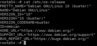

I try to install DirectAdmin on Amazon Lightsail follow this steps.
The OS is Debian 10. Apache version is 2.4.
The problem occurs after running this script
./setup.sh auto
The error is "mod_systemd has been requested but can not be built due to prerequisite failures" as in the picture below. Please give me a suggestion on how to solve this problem.
Is apt-get functional? Try:
apt-get -y install libsystemd-dev
Hi, smtalk
Thank you for your replied. I already tried install libsystemd-dev and run the script again. Still stuck at same error.
