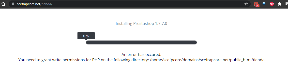

Hi guys, i'm trying to install prestashop on one of my servers but i get this error when i try
My server is configured to use:
Php 7.4/8
Php mode FastCGI
Mysql 8
Webserver mode: Nginx_Apache
Well... the error says it all.. No write permissions on the directory /tienda so that is were to look.
If you login to SSH and go to the public_html directory, what is the output of: ls -ld tienda

Because a workaround from the same Prestashop forum told this.
After the installation was completed i set again the permissions to 775 for folder and 755 for files
