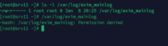

i got problem sending emails from my roundube instalation, when i try to send it has "successfully sent" notification, but nothing found on target email.
I try to check the mail log ( i use exim ) but got "permission denied"
here's the screenshoot :
what is the correcct user & group for exim & its log? anyone know how to fix this email problem?
You are using the wrong command.
Just using /var/log/exim_mainlog is probably twice wrong because it's /var/log/exim/mainlog directory wise (on RH alike systems). Second error is that you specify the file, but did not use a command to look into it, which is why you got the error.
But to look in it, you need to either use an editor (like nano or vi) or use the "less" command and scroll.
Those are basic linux instructions, so it might be wise to learn some basic Linux on the side.
Next to that there is also a roundcube log.
Try like this (at least on Alma linux or RH alike systems):
less /var/log/exim/mainlog
