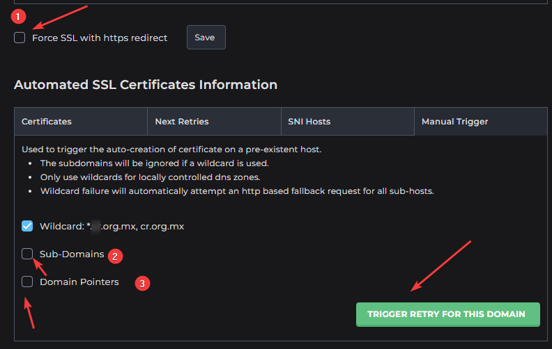

My friend, i have some questions:
Its neccesary to enable that options 1, 2 and 3?
If i want to use the wildcard do o ned tro press the green button, trigger retry?
Thanks in advance
Button 1 is a choice if you want automatich redirect to your site in https. I would use that, but it's a choice.
As you can read, subdomains will be ignored if a wildcard is used, so no need to enable option 2.
For 3, are you going to use pointers then? If not, then do not enable. As far as I know that is also not required for pointers but if you want to use pointers you can enable it. It will be ignored if not required with wildcard.
