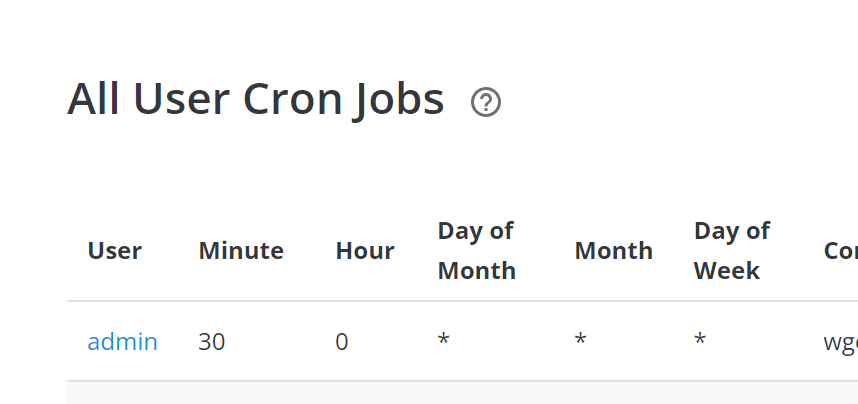

thanks, i was thinking to place a cron in "all user cron jobs" section -
You can use crontab -e as root which works like the vi editor.
You can also use the /etc/crontab file, in that file is also some explanation of usage.
