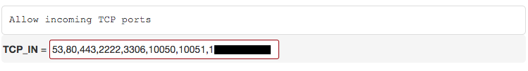

Hello, I have a mixed issue here. I have a DA 1.6.server with ssh on port 1xxxx set in csf.conf and CSF set to listen only on a number of ports < 10000 with port 1xxxx added as addiotnional portnumer to listen on. Also, root login has been disabled in sshd_config with 'PermitRootLogin no' and user root is not listed with AllowUsers. I thought I'd made not possible to login using SSH on ports > 1xxxx and with user root in general.

show your ipv4 ports screenshot from CSF config, maybe there are syntax error
I checked the config, there are no syntax errors there as far as I can see:
