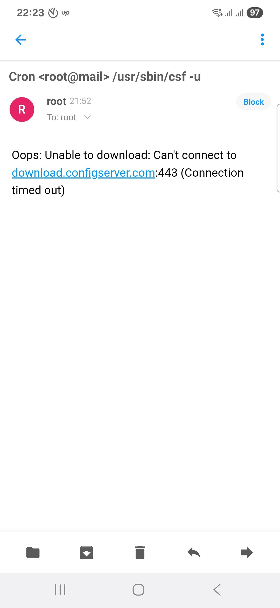

CSF update error notifications...
tarik
Aug 24, 2021
39
Also I found this news link is this any related with that:
Yes it's related. As they stop, also the update server stops. You have seen the thread in the right upper corner of the forum under the "Featured Content"? It's all about that issue.
To fix your issue for the time being, you can disable the auto updates.
You can disable autoupdates via the CSF GUI, or otherwise set the option AUTO_UPDATES = "0" in /etc/csf/csf.conf manually via SSH and restart csf/lfd and then the cron will be automatically removed and will not come back on a restart.
yes but as i heard it will continue to operate via github , do you know when it will become officially maintained on GitHub and how to update it...
No they just gave it free under GPL via github so others can make a fork and work on it, several did. The CSF devs stopped and will do nothing anymore also not on Github.
Like @Active8 said DA has a fork itself and maintains itself now. So best is to keep the one from DA.
Yes dear Richard so that means Yes that is good so that means that DA takes itself the CSF to be maintened and updated!?... By custom build...
