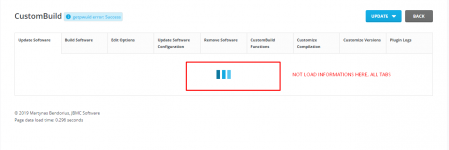

L leolage Verified User Joined Jul 2, 2019 Messages 6 Dec 17, 2020 #1 Hello, I was installed directadmin on Debian 10, all work correctly on server, but custombuild is empty on web interface of directadmin, with a message: getpwuid error: Success below the print screen. I already try to do a custombuild update but not errors and problems persists. Attachments da-error.png 26.1 KB · Views: 79
W warg Verified User Joined Nov 30, 2020 Messages 164 Dec 17, 2020 #2 This is how you fix it: https://forum.directadmin.com/threads/empty-or-blank-update-listed.62561/#post-323558
