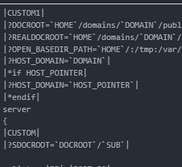

That didn't work for me... I checked virtual host block aswell it still redirects to the old document root
Can I use the same document root setter that I did for domain.com or does it need to change for the api.domain.com

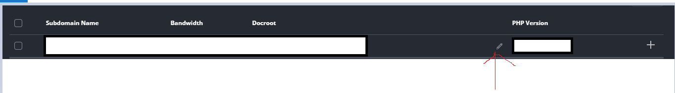

Ahhh, it's should working, maybe you put on wrong customize block.
...ehhh nevermind, it's hardcoding inside template
just customize via GUI.
Thank you that worked!
