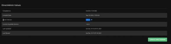

i want update php extensions with ./build php n command . but , when hit this command returned below error
message say must be update da , now i want update DA here and returned below Error :
i try update manually with this instruction https://docs.directadmin.com/directadmin/general-usage/updating-da.html#manual-update
download update.tar.gz file then extract file . nothing happening, just update version from 1.61.5 to 1.62.3
still problem not solved . after this update , i try update manually again, just returned error can`t download update.tar.gz, error 400
Please Help me , thanks
"Your DirectAdmin version (1.61) is older than minimal required for this version of CustomBuild (1.63). Please run '/usr/local/directadmin/custombuild/build update_da'"
This is an automated message notifying you that an error has occurred while trying to update the software.
The generated error message is as follows:
Unable to connect to 167.172.23.237
Unable to connect to secure socket: Some I/O error occurred. The OpenSSL error queue may contain more information on the error. If the error queue is empty (i.e. ERR_get_error() returns 0), ret can be used to find out more about the error: If ret == 0, an EOF was observed that violates the protocol. If ret == -1, the underlying BIO reported an I/O error (for socket I/O on Unix systems, consult errno for details).
Unable to connect to 216.144.255.179
Unable to connect to any site for the update
Please contact JBMC-Software, including the error message. Failure to do so could result in an inactive control panel.
