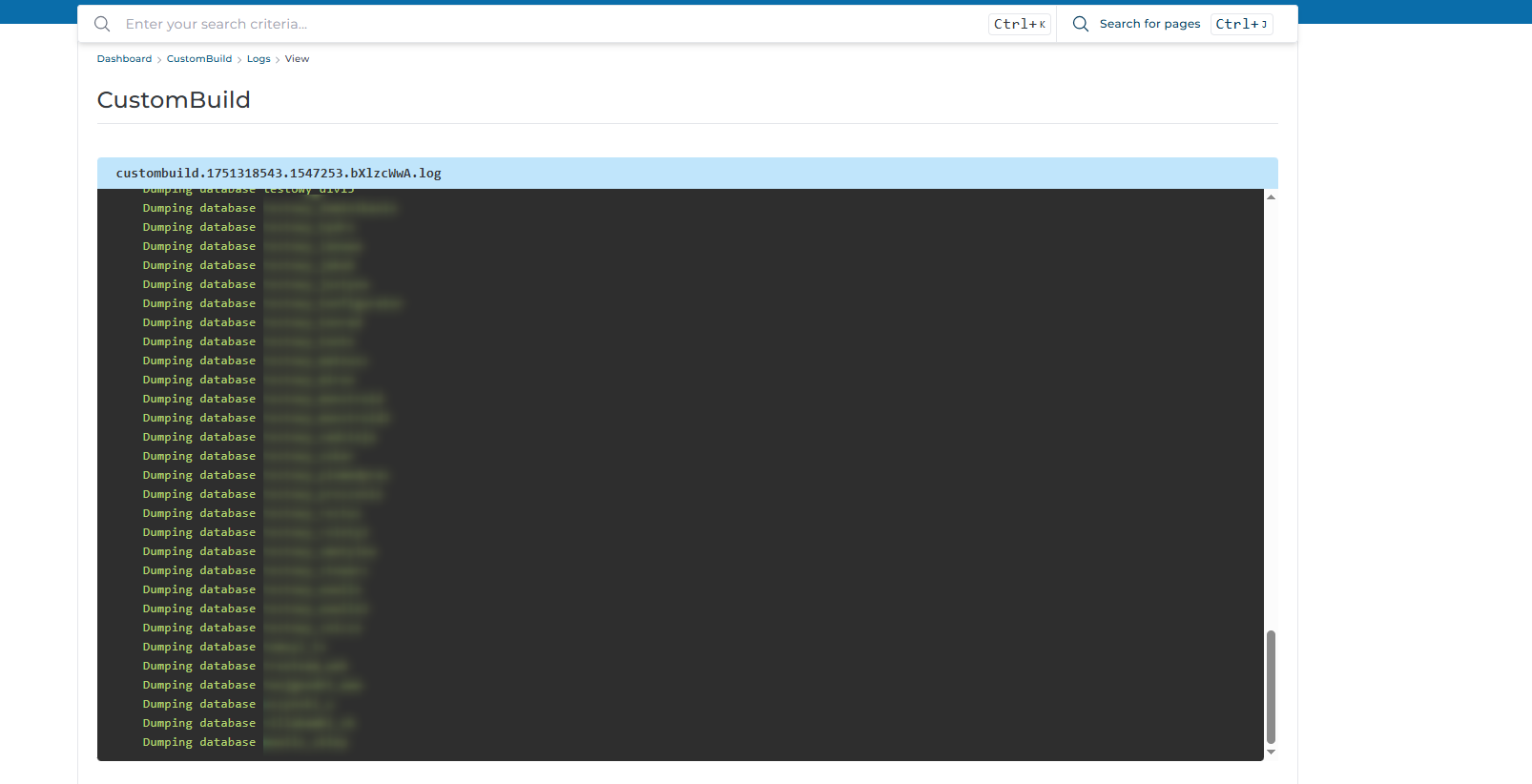

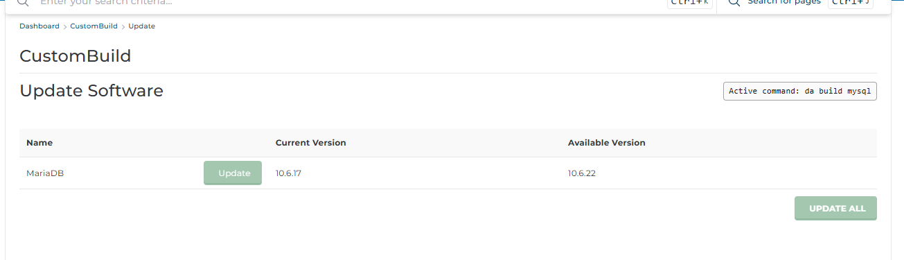

Hi, I launched separately custombuild updates for every part of software, like PHP, Apache etc. last one I launched MAriaDB update
Now I see that this update log stopped at screen like attached
What can I do if it looks like it is in process but there is no info that this process is going on on popup in DA panel (like it was in every other update) ?

Then it's still running and dumping the last database. I assume you have a large database that needs to be dumped to a sql or sql.gz file.
I see the Update button is darker green and you cannot push the Update button, so it has to be still running
