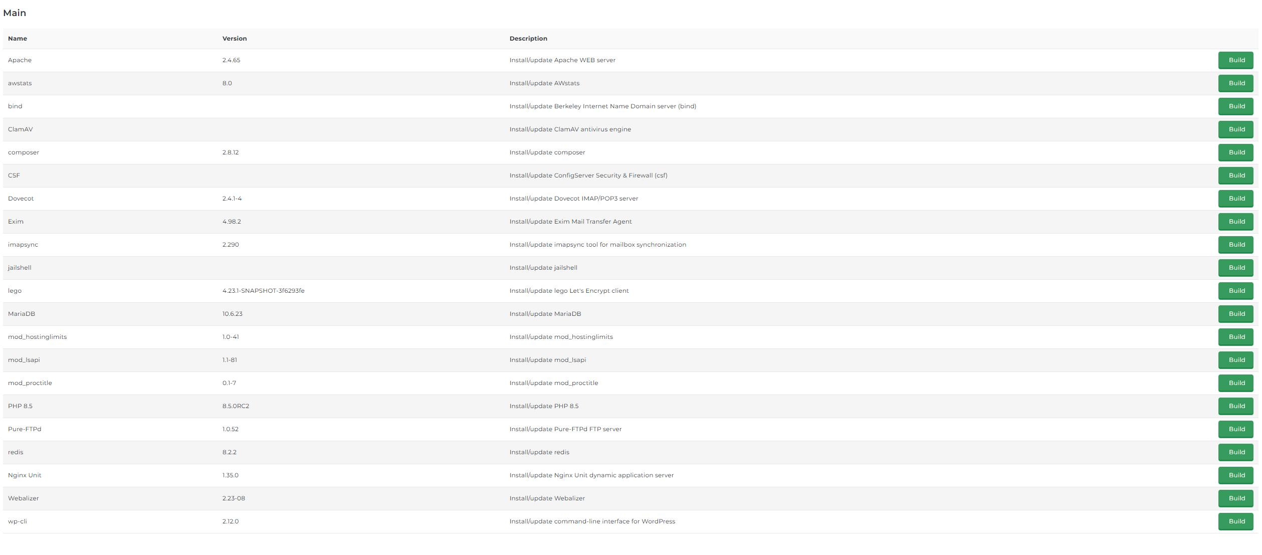

I’m in the middle of migrating from cPanel to DirectAdmin and trying to set up a clean server with CloudLinux 9 (latest) and LiteSpeed (paid, not OpenLiteSpeed). I am facing issues like
Native PHP version is not installed ("/usr/local/php5/bin/php-cgi" binary is missing), thus CloudLinux PHP selector is not able to work. etc
At this point, I’m unsure about the correct installation order — should LiteSpeed come before or after DirectAdmin setup? And is there a specific way to make the PHP Selector integrate cleanly with DA’s custombuild?
Since I’m coming from cPanel (where CloudLinux + LiteSpeed worked flawlessly), I’d love to know if anyone has a reliable step-by-step or migration-friendly process for this exact stack:
CloudLinux 9
LiteSpeed Enterprise Web Server
DirectAdmin
MariaDB
Softaculous
immunify360
JetBackup etc
Also, what components should I select for above config?
Any guidance or personal experience would really help — I’m trying to make the switch cleanly without breaking PHP Selector or CageFS support.
Thanks in advance
