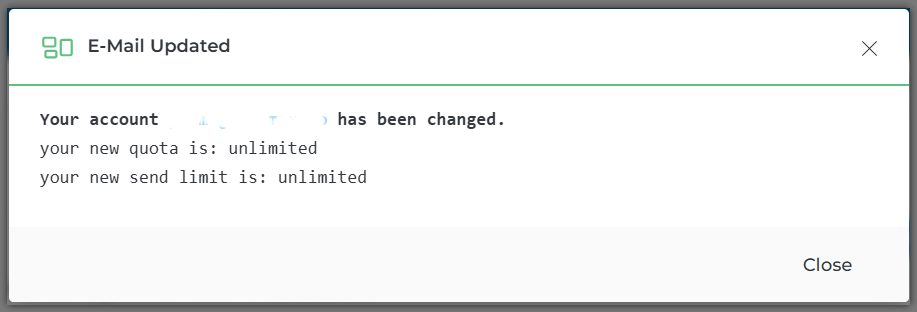

Later edit:
You are correct Richard,
After changing those 3 files value to 0 I was able to check "Unlimited" into DA email account.
