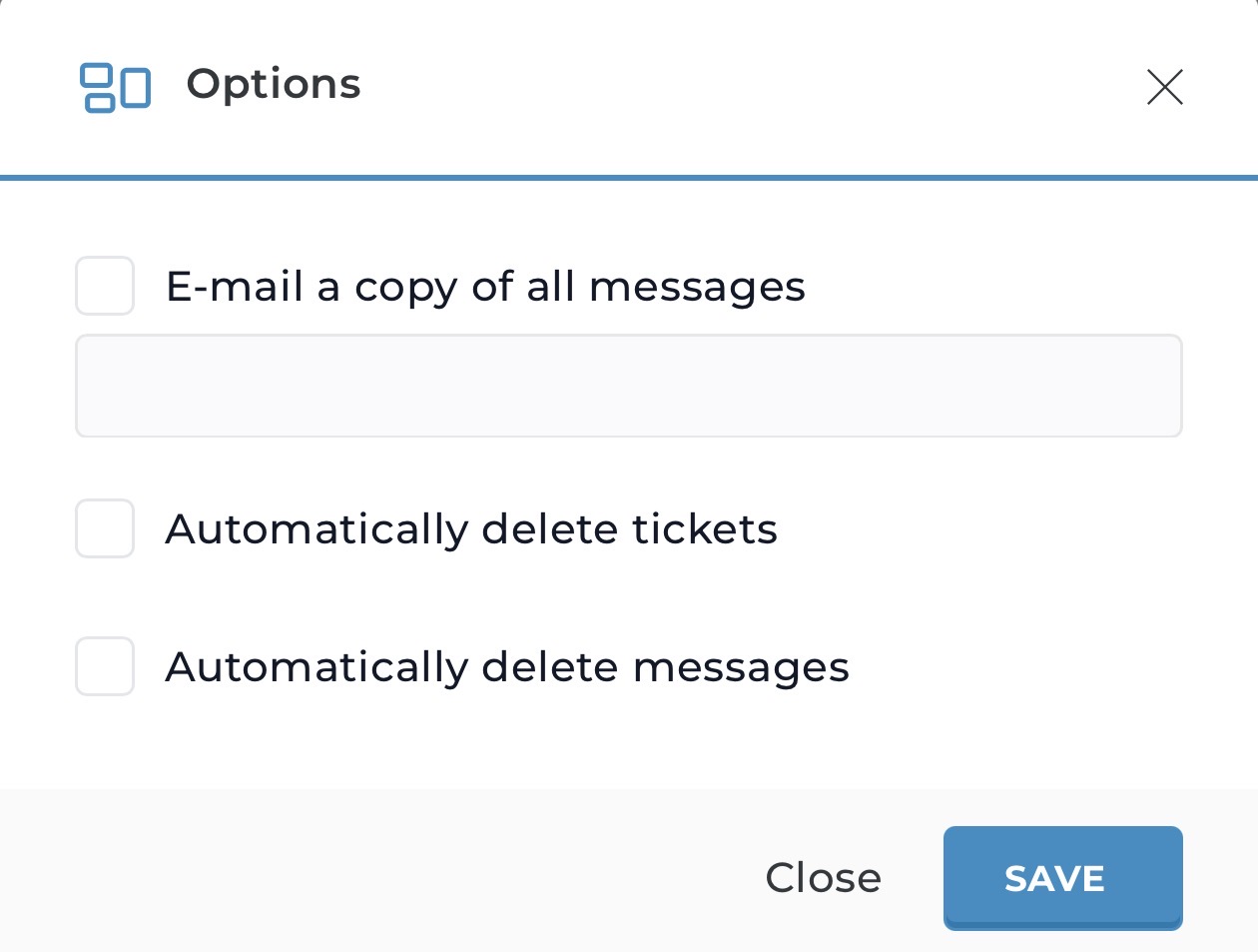

Also I just noticed that in this version we've lost the clear feature from message system. It was really helpful to only delete the ones I want. It had a clever search feature to remove the ones I actually want to remove. Is it possible to get it back with an option or is it completely gone?
@altayevrim, the message clear feature is no longer needed because the main messages list now has a search feature. You can search for specific message text and then combine select all and delete actions to delete a specific type of messages.
The new search is more powerful it can search message body, here the search finds User john has been backed up line inside the messages.
Thank you for your detailed answer. I used the method you provided actually in order to remove the messages. But since it is powerful it sometimes displays the messages that I do not want to remove as well :) Select all + deselect the items and delete action trio makes me miss the old feature but if it is gone, it is gone. There's nothing we can do about it.
One thing though, select all you mentioned, does it include the other pages as well or the current page only?
The select all action will select only the visible messages (a single page of messages). It means deleting large amount of messages might require repeating the delete action.
