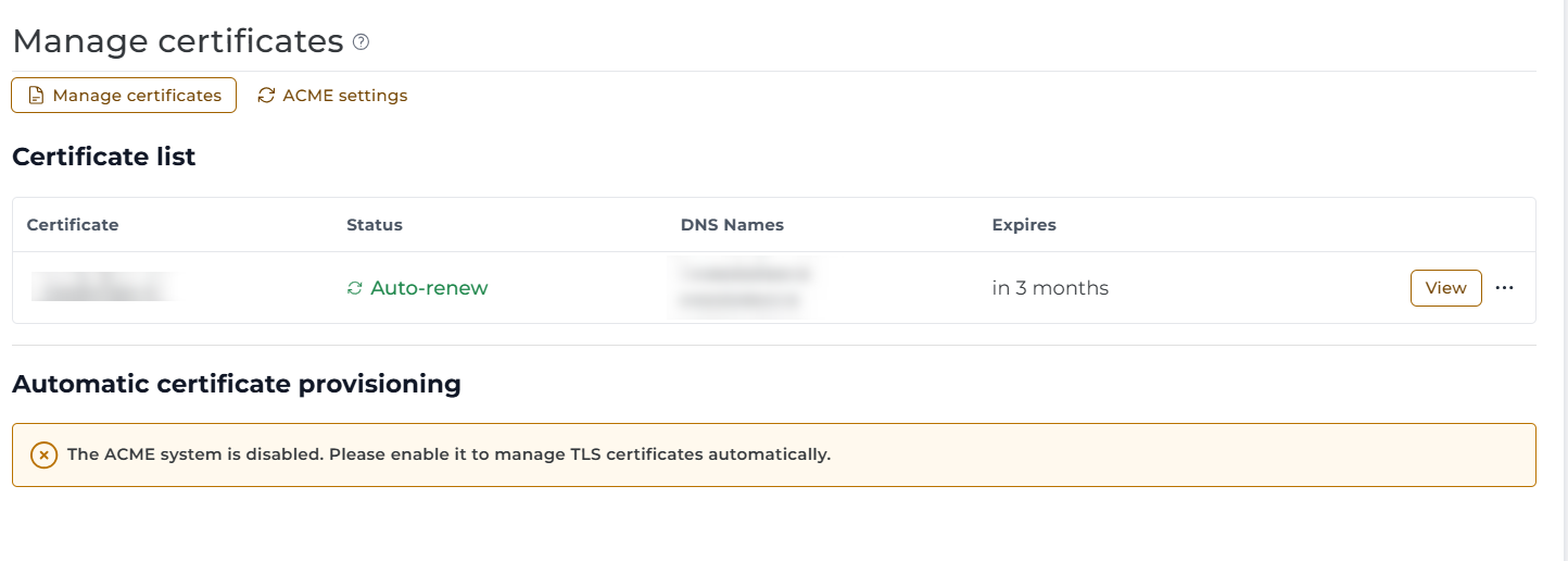

@Joriz, you can remove the certificate management page section by adding the `domain-tls` command to never_commands. Example:
# da config-set never_commands domain-tls --restart
(note this will replace any existing commands listed there, if you already use this feature append the domain-tls command instead of replacing).
This completely disables the 'Manage certificate' feature. We only want to disable the ACME feature as we have already Let's Encrypt automated.
Customers still want/need to install certificates manually they eg bought at Comodo.

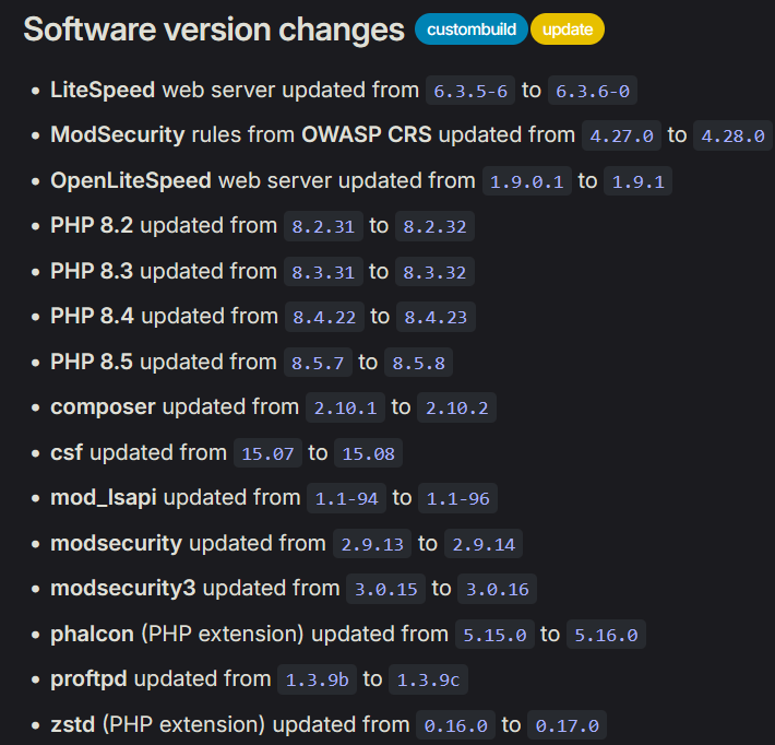

A new build is released. Changes:
* Exim version to bumped to 4.99.5.
* The snidomains file generator is improved, users with malformed configs will no longer block other users from updating certificates.
* The OLS installer script is updated to not leave OLS in a broken state, thanks @webbasica.
