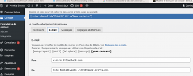

AWS does not want to open port 25. I try to use a plugin on wordpress sites to send emails with port 587 but it doesn't work.
I therefore use the email address settings on directadmin :

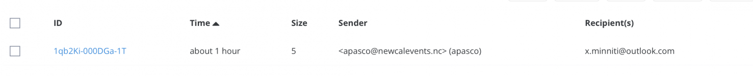

2023-08-31 16:29:50 Received from [email protected] H=doppio.minnicoffee.ovh (www.lc-creation.nc) [13.54.199.177] P=esmtpsa X=TLS1.3:TLS_AES_256_GCM_SHA384:256 CV=no A=login:[email protected] S=1641 id=[email protected] T="Message depuis lc-creation.nc"
2023-08-31 16:29:50 [email protected] R=lookuphost T=remote_smtp defer (-54): retry time not reached for any host for 'outlook.com'
