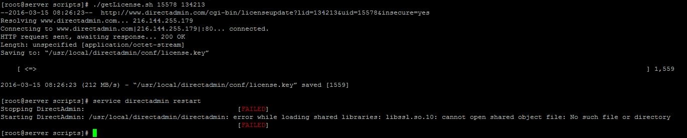

Hello
After the update centos my directadmin can not start ..
Please help me
Please make sure the OS in the license matches the OS installed on the server (CentOS 6 64-bit).
Agree, shahab you should remove the image or hide your UID/LID from that.
Is not that a problem because the license need to match the IP aswell, but still, is suggested :)
Regarding your problem, 99% of time is the OS Version set in DirectAdmin website license management not matching the one you've installed, i know it sound annoying, but are you sure you did double check it?

Well i've no ideas honestly, everytime i saw that error was OS/License related, maybe smtalk or DA Staff themself will be able to help you further.
Regards
So actually the binary you had were not for your OS, otherwise this wasn't going to fix the issue...
Anyway, glad you'd fixed your problem.
