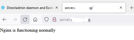

This error does not occur when accessing
hostname
instead of hostname:2222
