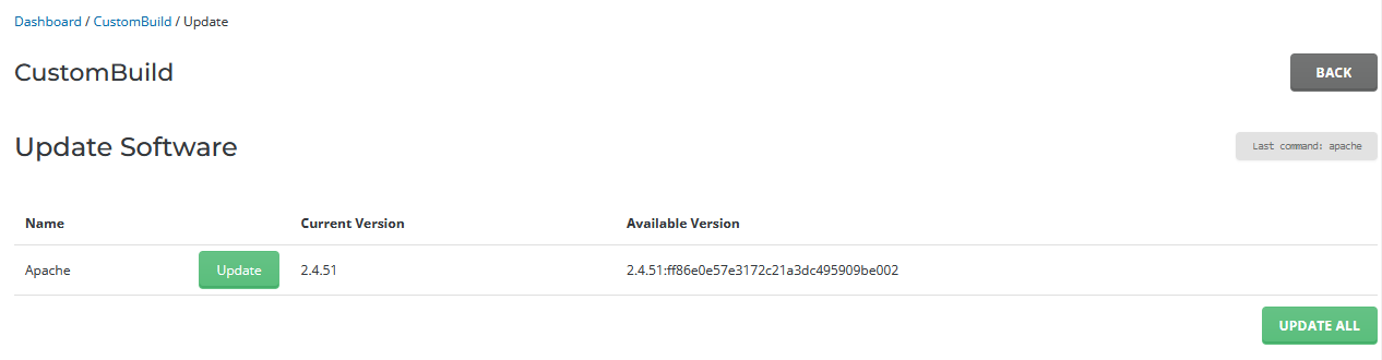

Hello;
I just updated one last server to the new version 1.645 (a110e936b78f4d6a24bfd649a414a218bed652ea) and an Apache update appeared available. (2.4.51:ff86e0e57e3172c21a3dc495909be002)
On all other servers it worked normally, only this one is reporting this update.
When trying to install the update, the following error message appears:
curl: (22) The requested URL returned error: 404 Not Found
Download of https://files.directadmin.com/servi....4.51:ff86e0e57e3172c21a3dc495909be002.tar.gz failed, re-downloading the file...
Download of https://files.directadmin.com/servi....4.51:ff86e0e57e3172c21a3dc495909be002.tar.gz failed 4 times, exiting...
and with that, the clamav-freshclam and the clamd@scan do not start.
Has anyone experienced this and know how to fix this problem?
Thanks.

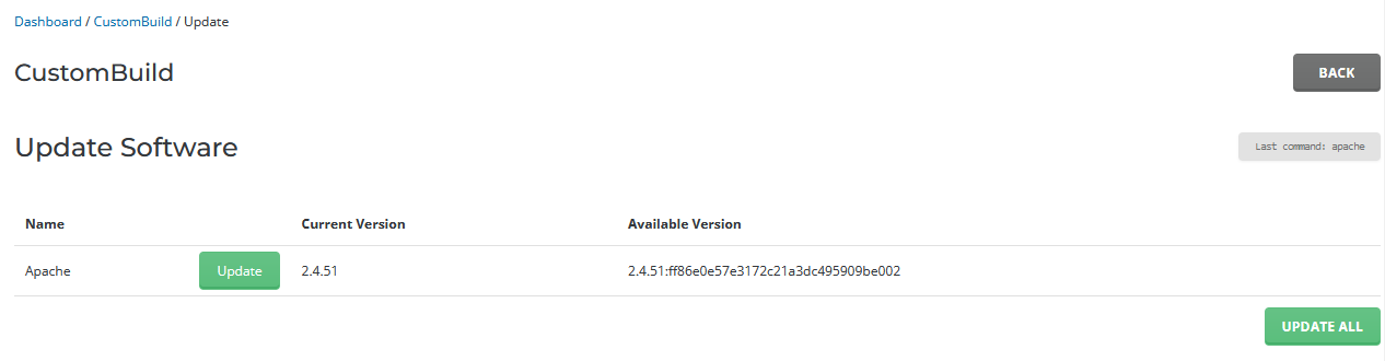

Hello;
Thanks.
Your apache version is not the latest. Maybe you have it defined in custom_versions.txt?
/usr/local/directadmin/custombuild/custom_versions.txt
Likely your customisation breaks the logic as new version files do not contain the hash strings anymore.
Problem solved with your help @nsc
For some reason, a custom version of Apache was set (I don't remember changing that).
I removed this change and now yes the update occurred normally.
Thanks! :)
