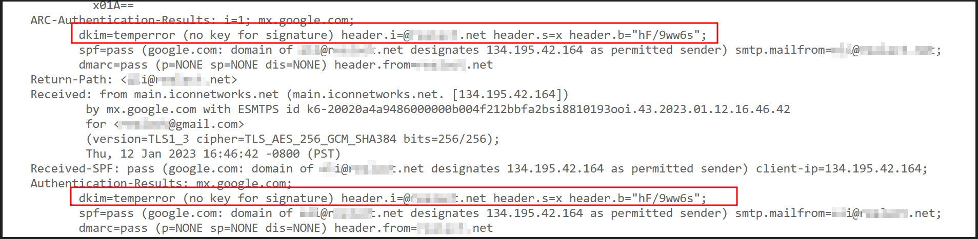

I have followed some guides for doing the same in DirectAdmin, SPF and DMARC pass, but DKIM check fails. When sending mail from my domain to GMail this is what it reports:

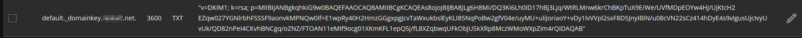

My DirectAdmin DKIM record I have set as follows:

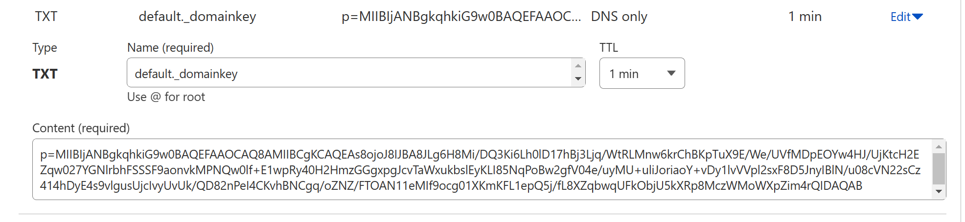

And then on my CloudFlare DNS section I added this way:

Hmmz... I wonder which guides you were following because it certainly does not look well. As normally DA uses the x and not default.
Directadmin creates the key for you automatically, nothing much you have to do yourself except for copying the recors if you use an external DNS.
Have a look at this.

First of all thanks for helping. Perhaps it was an outdated guide I found. Since it wouldn't work with that guide either I ended up using the same record I had on CPanel to see if I could make it work.
As soon as I get home I'll follow the instructions you sent me. However how do I remove the current changes? Do I just disable DKIM for the account in DirectAdmin then enable it back and that will reset everything in the DA configuration?

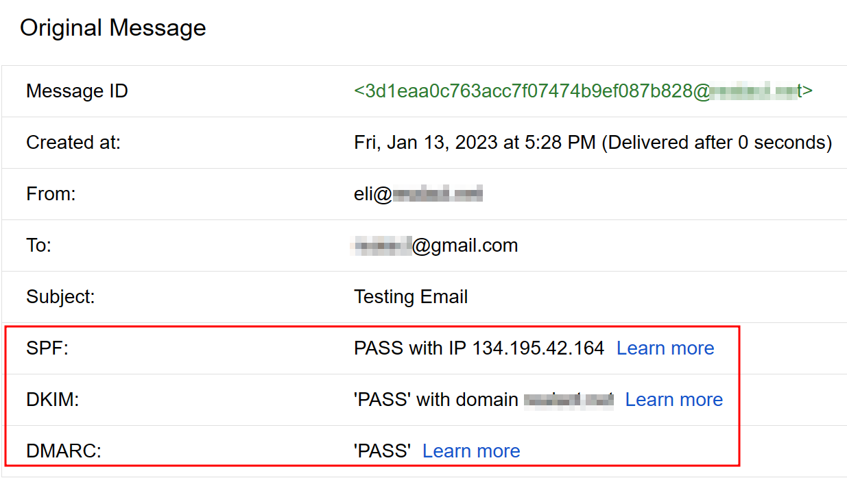

Thanks a lot, it looks like I was overthinking this more than I really should have. After following your advice, it's now working properly and mail arrives with all PASS checks.
Thanks a lot for your help.
