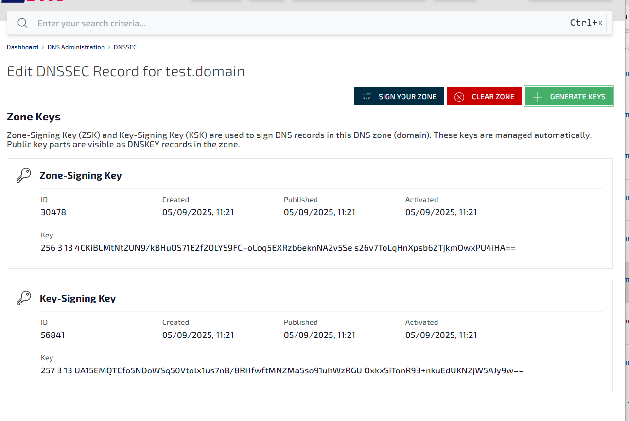

From the admin control panel, select DNS Administration, then select the domain you want to add DNSSEC to. In the right hand corner at the top, you'll see DNSSEC.
Then select generate keys, accept the warning and you're given this:
Think that's what you need? For some reason, DNSSEC isn't available on the DNS Administration as a user. Not sure if that's a bug, or by design. Sure a few others here may be able to let you know 😁

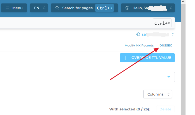

You are mistaken. Did you look where I said on user level? Upper right corner in DNS administration?
The user level needs DNS Administration activated.
Once activated, the user -can- generate DNSSEC keys and they are also shown at userlevel. I attached a screenshot so you can see.
The DNSSEC button on user level is not visible and or accessible by default.
It is a different setting that you need to add to allow DNSSEC on user level.
