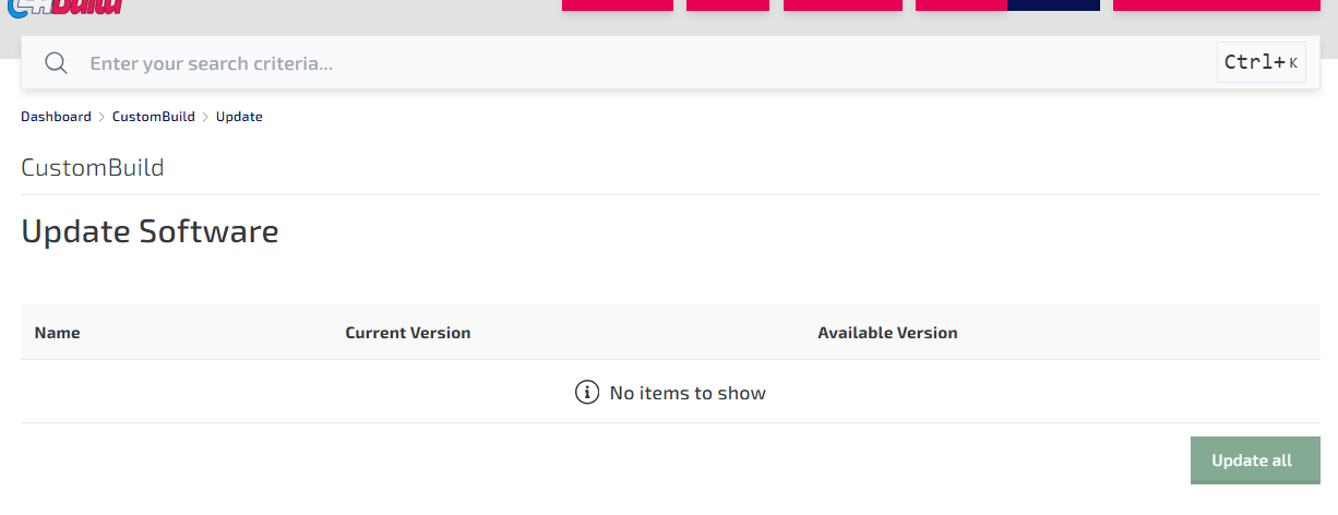

Here's my build server that's updated.

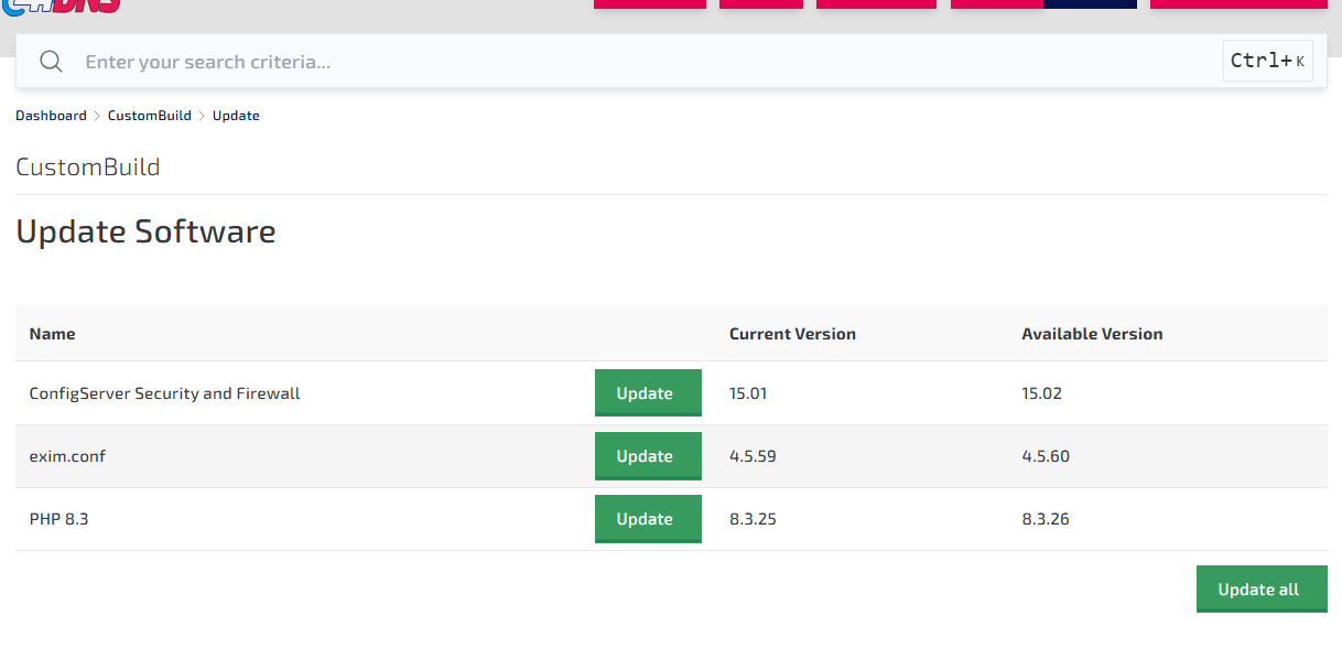

Here's a DNS server i'm just updating today due to latest release
