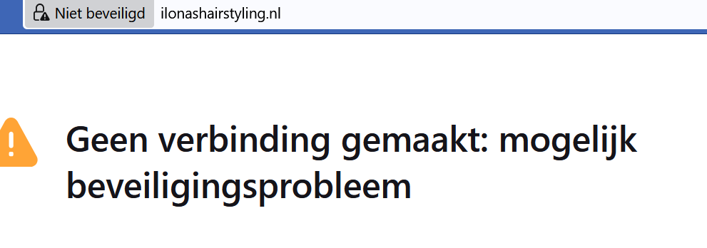

Hello all,
I've moved 2 days ago to a new hosting party. On the old one I had for a test website as well the main site it's own reseller. I changed the structure now to publish a test-website as a subdomain. It mains it is sharing also the ssl-certificate.
I'm using Let's Encrypt. I've created the shared certificate, including the main domain, however when I visit the site, I get a cert error (and it pointing to the server-domain instead. Can you guide me with what is wrong?

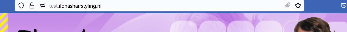

When I visit the uat of test websites, it is working fine.
