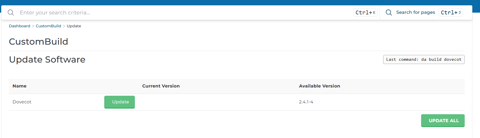

Still not working and that is on all servers, not one. I waited a lot. Can't understad where the problem is. This is what I get in DA Custombuild-Update:
checking whether SSL_CTX_set_tmp_dh_callback is declared... yes
checking whether SSL_CTX_set_current_cert is declared... yes
checking whether SSL_CTX_set0_tmp_dh_pkey is declared... no
checking whether EVP_PKEY_check is declared... yes
checking whether OPENSSL_buf2hexstr is declared... yes
checking whether SSL_get1_peer_certificate is declared... no
checking whether SSL_CTX_set_client_hello_cb is declared... yes
checking whether SSL_CTX_select_current_cert is declared... yes
checking whether SSL_client_hello_get0_ciphers is declared... yes
checking whether SSL_CTX_set_alpn_select_cb is declared... yes
checking for libunwind-generic... no
checking for lua >= 5.1 lua != 5.2... no
checking for pam_start in -lpam... no
configure: error: Can't build with PAM support: libpam not found
doDovecot: failed to compile '/usr/local/directadmin/custombuild/cache/dovecot-2.4.1-4.tar.gz' inside '/usr/local/directadmin/custombuild/tmp/tmp.v0kX4Urf09.dovecot-2.4.1-4.tar.gz'
failed to build dovecot
