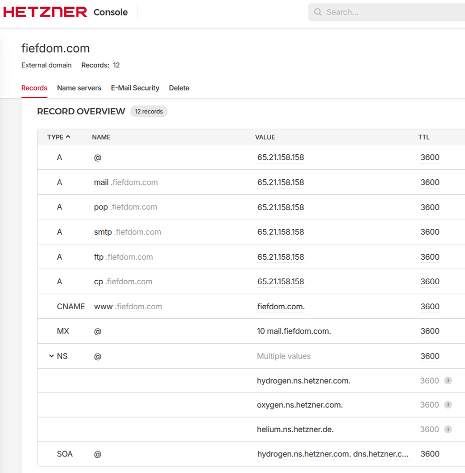

Can't see any issues if you're using Hetzner for their DNS. If you wanted to take advantage of DA for the DNS, it's really good. You'd need to create some glue records for your domain to effectively point to itself. Each NS would have your servers IPs glued to them and DA would create the DNS records for it. I run my own nameservers (have three separate DA servers solely for that purpose)
mail.domain.com is pretty standard for MX records. Again, you'd have to create them with Hetzner, along with an A record for your server hostname. I'd recommend you do that before you install DA as the TLS cert for the control panel will create itself instantly.

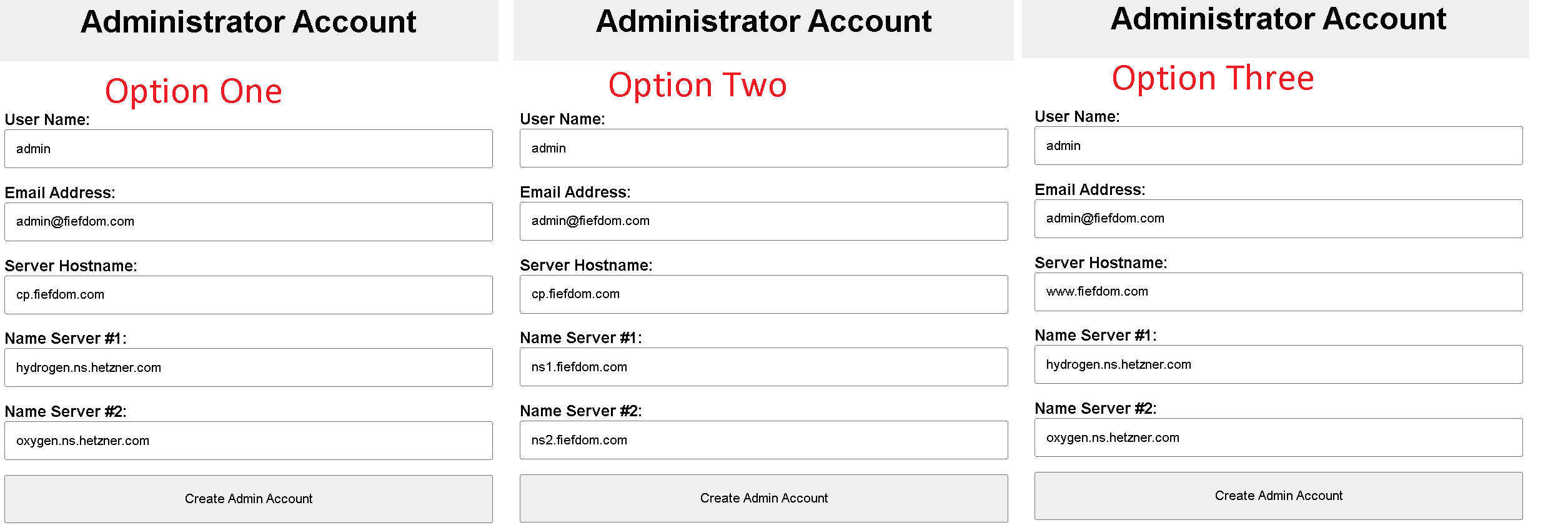

I would also recommend setting the env variables DA_NS1, DA_NS2, DA_HOSTNAME and DA_EMAIL before you run the install script. If you don't, you run the risk DA creating it's own login, and panel login and you'd have to go and change the hostname in DA manually. Also if you run install script without the licence key, you can take advantage of the web installer which is new and spicy.

However I would suggest to set a correct FQDN hostname (click) to begin with if you want to mail from this system too.
A correct hostname is for example server.domain.com and then you can also create ns1.domain.com and ns2.domain.com for your admin domain to keep things easy and eventually easy to adjust for later.

If you do not run your own nameservers but external ones (like Hetzner or any other external DNS), then indeed you have to copy the records you want to use from DA to that external DNS which an can also be another registrars DNS, unless you want to register all your domains with Hetzner.
Be aware that also goes for SPF and DKIM and for example DMARC records if you want to use those too and the same for ipv6 records.
