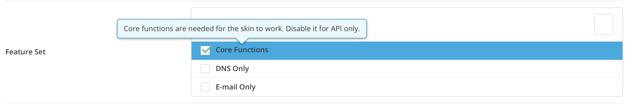

"SSL settings" is not in e-mail feature set. I can be added optionally. Thank you for the ideas above, we'll think something on it :) Regarding the text - it was already there, attaching.
Thank you. However it might be a good idea to make the text visible when hovering over the complete bar or something.
It's not visible on the selection box and not visible anywhere else, only when the mouse is exactly over the text itself (the reason I missed it too), not even half a mm under the text.
