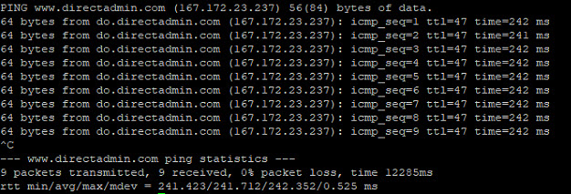

Error downloading the license file from relay server as well. curl code 28. When installing.
visualchw
Dec 18, 2021
7
OS : AlmaLinux 8.5
Please, I have been facing this problem for 3 days.!!!
There is not a supported server listed as do.directadmin.com
Try running
./build update
./build set_fastest
problem is when new install.

Using data: license_key=eAHG2i8KfC.....%3D&insecure=yes
Warning: Transient problem: timeout Will retry in 1 seconds. 3 retries left. # # #
-=O=- # # # #-=O=- # # ##-=O=- # # #-=O=- # # #-=O=- # ##-=O=- ###-=O=- ###-=O=- # #-=O=- # ##-=O=- # # #-=O=- # # ##-=O=- # # # #-=O=- # # # #Warning: Transient problem: timeout Will retry in 2 seconds. 2 retries left.
Warning: Transient problem: timeout Will retry in 4 seconds. 1 retries left.
-=O=-# # # #
curl: (28) Resolving timed out after 5000 milliseconds
Error downloading the license file. curl exit code 28
Trying license relay server...
Warning: Transient problem: timeout Will retry in 1 seconds. 2 retries left. # # #
-=O=- # # # #-=O=- # # ##-=O=- # # #-=O=- # # #-=O=- # ##-=O=- ###-=O=- ###-=O=- # #-=O=- # ##-=O=- # # #-=O=- # # ##-=O=- # # # #-=O=- # # # #Warning: Transient problem: timeout Will retry in 2 seconds. 1 retries left.
-=O=- # # # #
An error has occured while attempting to download the license.key.
I found a problem at /usr/local/directadmin/scripts/getLicense.sh
I edit timeout. But when I install. it was replaced with a new file.

I reordered the DNS again give DNS1=8.8.8.8 and followed byprovider's DNS.
Good deal. Yes generally its best to use a known good recurser dns like 9.9.9.9.
Sometimes Datacenters try to use their dns in their server setups. I have found several that do not work or point to a Local DA mirror inside the datacenter. The issue is they are not usually updated every day.
