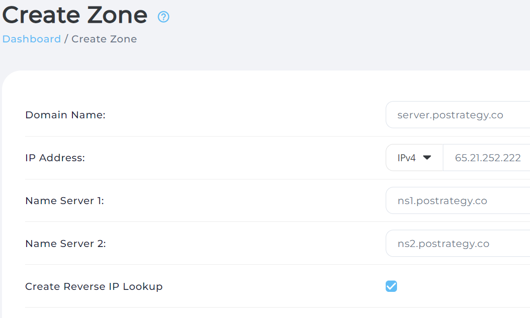

You missed point 2. You did not create a DNS entry for your hostname via the DNS manager.
So the reverse DNS is correct now, but an nslookup at server.postrategy.co will result to nothing, which is causing the roundcube issue.
To fix this, please create a seperate DNS record in DNS manager (so NO subdomain record!!! but seperate entry as if you would create a new domain) with server.postrategy.co als "domain name" and fill in the ip and nameservers.
Then that part should be fine and roundcube should start working again too if that is synced.

You created those automatically, you don't need those in DA, you best remove them.
First screenshot is good, the one which I liked. Only reverse did not need to be checked.
after creating in first screen shot, the second screenshot was added automatically.
although I had been written "server.postrategy.co" in "Domain Name:" in first screenshot, DA was added 222.252.21.65.in-addr.arpa as a domain name and when clicking on it, the second screenshot is showing.
