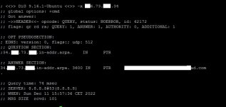

If I use a valid Host in IPv4, but it seems to me that my service does not allow me to do the same in IPv6 or if there is any way I would appreciate it.
Did you create a PTR record at your ipv6 provider (datacenter mostly) for your hostname too?
Because you need to have a PTR record for both ipv4 and ipv6 if you want to use both.
And it seems you don't have a PTR record for your ipv6 ip yet.
So if it is a Google Cloud you might take a look at this page: https://cloud.google.com/compute/docs/instances/create-ptr-record
If they do not allow to change PTR records for IPv6, then you might disable Exim from using it per this guide: https://docs.directadmin.com/other-...iled-address-family-not-supported-by-protocol

Well I stopped using IPV6 and now the mail messaging works correctly.
