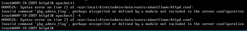

What happened before the failure is this: I tried to upgrade the PHP-version through custombuild 2.0. I've also clicked on some other updates that I though was ok. Custombuild kept coming with more PHP update (version 7.0.xx to 7.4.xx etc.) but Ididn't go all the way. On the user level the version remained 5.6 and then I decided to restart the VPS. Since that moment the httpd process doesn't start anymore. Through DirectAdmin I see the error: "/sbin/service httpd start 2>&1".

There are indeed some errors, but nothinh that I can relate to this problem?

I rather would check the Custom HTTPD settings at Admin Level maybe you got some custom configs in there?
You have some customization in that file on line 21.
You most likely need to fix that first. Note: If you edited the standard apache conf file when the customization was made. You can't do it that way DA is a Templated system.

We've fixed the issue the server is is running a EOL version of CentOS with some none working repositories so he was missing the repo's to make the installation/update process correctly.
We enabled the CentOS 6 vault, after that we could recompile apache/php because he was missing expat-devel and libwebp.
