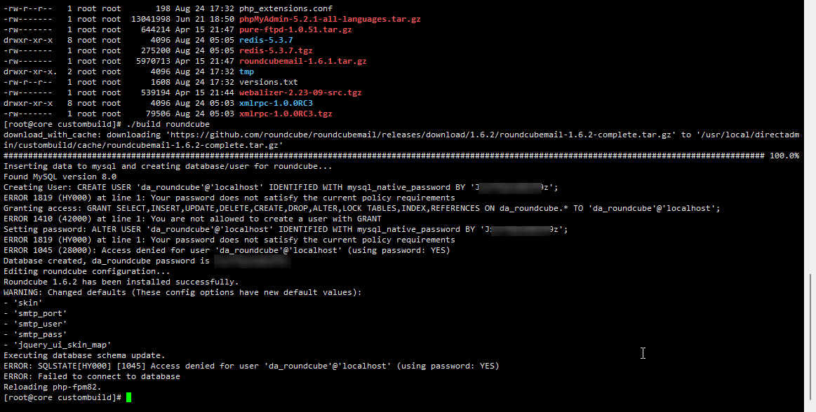

Hi guys when i try to build roundcube i get this errors
If i check if the DB is created, seems that is not created
Must i set the admin and pass for the mysql account on any config file or what?
Thanks in advance
Hi Richard, thanks for reply i'm stuck at step one of the link you gave me, when i execute the command for reset root password
If i check the file
/usr/local/directadmin/conf/mysql.conf
I see this, the user for mysql is admin instead root, if i use it to login on phpmyadmin, it works normally
If i try to build roundcube i get same error
It is like directadmin is not using the right credentials for mysql
I appreciate the time you take to respond and I ask you to please be patient, I'm new to directadmin, I'm fed up with cpanel!

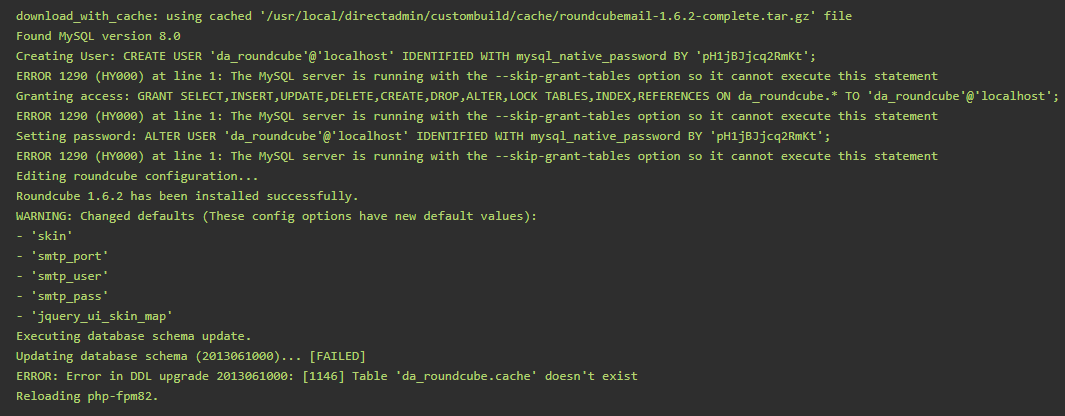

Edit 2
Seems that the roundcube DB exist on mysql,
now i have another problem
--skip-grant-tables
This happens when i executed
systemctl stop mysqld
systemctl set-environment MYSQLD_OPTS="--skip-grant-tables"
systemctl start mysqld
I already do a FLUSH PRIVILEGES; as root and as admin
But seems that it not works
