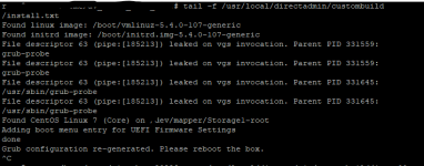

I got error while installing the custombuild.
# tail -f /usr/local/directadmin/custombuild /install.txt
Found linux image: /boot/vmlinuz-5.4.0-107-generic
Found initrd image: /boot/initrd.img-5.4.0-107-generic
File descriptor 63 (pipe:[185213]) leaked on vgs invocation. Parent PID 331559: grub-probe
File descriptor 63 (pipe:[185213]) leaked on vgs invocation. Parent PID 331645: /usr/sbin/grub-probe
Found CentOS Linux 7 (Core) on /dev/mapper/Storage1-root
Adding boot menu entry for UEFI Firmware Settings
done
Grub configuration re-generated. Please reboot the box.
What sould I do to fix?
I believe these warnings are harmless and can be safely ignored, I know there are a couple of bug reports for Ubuntu that have been active for quite a long time but no solution have been given as of yet.
Your current system should be fine, I don't think you need to switch OS right now. These warning messages at least should not be the reason to migrate to a new system.
CentOS 7 has security fixes till 06-2024 so you should plan your migration before this date. DirectAdmin has support for several distributions so you can choose according to your own needs and preferences.
System Requirements:
https://docs.directadmin.com/getting-started/installation/overview.html
You right , but php wont worked and I need that to work with litespeed , so I migrate
Thanks
