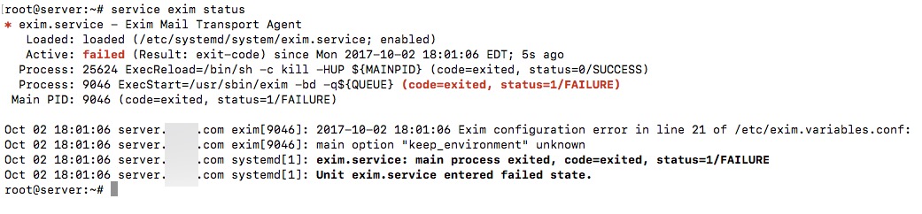

Hi All,
how to fix this error
root@server:~# service exim status
* exim.service - Exim Mail Transport Agent
   Loaded: loaded (/etc/systemd/system/exim.service; enabled)
   Active: failed (Result: exit-code) since Mon 2017-10-02 18:01:06 EDT; 5s ago
  Process: 25624 ExecReload=/bin/sh -c kill -HUP ${MAINPID} (code=exited, status=0/SUCCESS)
  Process: 9046 ExecStart=/usr/sbin/exim -bd -q${QUEUE} (code=exited, status=1/FAILURE)
 Main PID: 9046 (code=exited, status=1/FAILURE)
Oct 02 18:01:06 server.!!!!!.com exim[9046]: 2017-10-02 18:01:06 Exim configuration error in line 21 of /etc/exim.variables.conf:
Oct 02 18:01:06 server.!!!!!.com exim[9046]: main option "keep_environment" unknown
Oct 02 18:01:06 server.!!!!!.com systemd[1]: exim.service: main process exited, code=exited, status=1/FAILURE
Oct 02 18:01:06 server.!!!!!.com systemd[1]: Unit exim.service entered failed state.
root@server:~# ./build clean
-bash: ./build: No such file or directory
root@server:~#
It seems you have a error in /etc/exim.variables.conf, did you edit that file? Try overwriting it:
./build update
./build exim_conf
./build exim
You have outdated version of exim, which does not support "keep_environment" variable. Yuu need to update exim as user ditto suggested.
You might need to run
./build set exim yes
before running
./build exim
if exim does not update.
