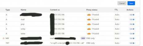

image from cloudflare.com
I receive but can't send email...

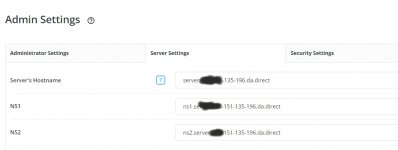

I am sure you are not the owner of da.direct domain :)
Check you domain and DNS settings + hostname
I don't know why it shows da.direct
Nowadays this is the default hostname setup server-xxx.xxx.xxx-da.direct where xxx.xx.xxx is your server's ip address.
This is so you can visit the server via https when it's installed.
I'm not happy with this procedure because it will cause these kinds of mistakes. However, it was DA's choice to do it this way. I would strongly suggest to create your own hostname. However that is your choice.
Result is that if mail is send via php, then it will be send from server.xxx.xxx.xxx.da.direct and not via server.yourdomain.com like should be.
However, what you see in the log, you should not be worried about. Because 93.123.118.118 is not your ip address and they are just trying to bruteforce [email protected] and [email protected] which domain isn't on your server anyway, so just ignore that.
