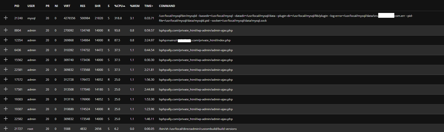

I'm having an issue for the past 3 days now and I'm unable to solve it or to find the problem.
Attached you can see that I'm having a very high load caused by the MySQL.
I tried to update mariadb, replace the Wordpress and content files with a backup just in case there is some kind of malware on my website. As for some reason, someone was able to reinstall Wordpress :s
I've rebooted the server with my host. I updated all files, plugins, etc.. but nothing seems to solve the high load.
Or maybe it's by a bad database backup restore or migration? What should I do in this case?
I have backups of all databases.

At the very end it would have gave some recommendations of changes for your /etc/my.cnf that would need to be added to the [mysqld] section. Adjusting the table_definition_cache, add skip-name-resolve=1 to disable dns lookups, and look though the end of the report for other adjustments. If you have a lot of databases/tables and they are large you will probably need more ram. It's a handy tool, also for best results it's best if the Mysql/Mariadb server has been running at least for a while under normal use.
Did you try to run SHOW PROCESSLIST with the da_admin user to see what processes are running?
