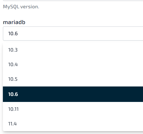

One last note my friend, I note at the beginning it was specifically a different version of MariaDB you wanted. Here's a screenshot of the available versions you can add to the custombuild.conf file to make sure you get the correct version. I'm off to build another server myself now. Good luck!

Thank you. I want to go with 11.4 :)

Can you tell me where do I get such a list of mariadb versions? Is it from DA web setup or somewhere in the panel?

Server install went well thank you. Regarding the list of available MariaDB versions, I got those from the custombuild page on DA Admin panel.
