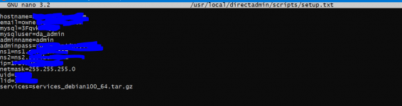

da_admin pass = /usr/loca/directadmin/conf/my.cnf
mysql root pass = /usr/local/directadmin/scripts/setup.txt
which by the way also contains the da_admin pass.
Normally you don't need the mysql root pass and use da_admin.

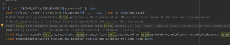

This is correct but not many people know (I've never seen this post on forum) that during Directadmin installation, it actually created a mysql root password (not the blank one but it doesn't use it). If you look at the installation log file, you will see the following line that said:
# /var/log/directadmin/install.log
####Setting password: SET PASSWORD FOR 'root'@'localhost' = PASSWORD('*******');
You can test login phpmyadmin with the username root and the above password. It works. That means, you should secure this password or secure your mysql installation with mysql_secure_installation command to not allow root login. Always block remote root login in mysql.

That is different. In setup.txt the username is `da_admin` (that was created by Directadmin as root user) but the one that I mentioned is root (with username root). During DA installation, it creates a short root password for me (it's different from da_admin mysql password and yes 'da_admin as root password' has been documented many times in this forum). Now I remember that I got this installation log directly from Putty terminal (eg. in Putty it has an option to copy all output to clipboard called 'Copy All to Clipboard'). I think it was not log in install.log maybe the output was not a standard output (only appear in terminal). I still have this note about this last few months on my custom installation script below and it appears on Debian):
The full output specific to sql password that I got was:
##### MySQL root password seems to be unset, setting using MySQL queries...
After I found this log file, I straight away use this in phpMyAdmin and it works (I was logged as root username not da_admin). The password in the log is visible not that asterik symbol. The asterik symbol I just masked it.

I was wrong about what I said above that setup.txt contains only da_admin sql password. sorry about that.
I remember I read from one post (I think I read it wrong) that Directadmin will never create or store mysql root password and starting from that moment I put a note and I never believe that this setup.txt contains mysql root password (as root username, I thought the password belongs to da_admin and it has the same location as in /usr/local/directadmin/conf/mysql.conf). Until I found that the root password is actually came from the terminal log I posted previously and I thought that the hidden sql root password is only came from that terminal output. Normally after DA installation (before I found the sql password log) I would reset root password manually through terminal (stopping mysqld)
Also if you look at setup.txt here, the way how the password is arranged is a bit confused to me as it doesn't mention that the mysql password belongs to root username (it's written as mysql=3Fqvk...., should put like mysql_root=3Fqvk... so that will become more obvious) and below it mysqluser=da_admin which makes me more confused that it is not mysql root password but only belongs to da_admin. Why would you put mysql 'da_admin' user here without putting its own password together in setup.txt? Confused right? or maybe change this variable mysqluser=da_admin to mysqluser=root and it becomes more obvious this mysql password in setup.txt belongs to root user.
Another thing, I might had overlooked at this high rank post for example when I try to search `where is mysql root password in Directadmin` from Google it appears first and the post did not mention anything about mysql root user. This is another reason why I didn't believe root password does exist in setup.txt and it's hidden somewhere and the way to recover it is by the last post (reset through terminal) ?
About the log file, yes it still there (not in setup log file but from terminal) and I just realized it has the same password as in setup.txt.
For many years, now I understand that setup.txt contains this mysql root password where mysql.conf contains only da_admin sql password.
I totally agree that this works very confusing. When I was looking at it a couple of years ago. I encountered the setup.txt and remembered the da_admin pass looked different in the my.cnf in the config directory. So I went searching and then found out this was the root pass.
